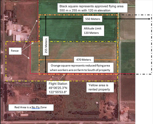

- Approved Flying Area is detailed in Figure 1 below.
- · No flying higher than 120m (400 feet)
- The default altitude limit is to remain below 400 feet above ground level. If higher is obtained this will be indicated in writing by either a Transport Canada SFOC or a MAAC certificate
- No flying in the Red No Fly Zone
- No flying over farm to the south when there are people on that field. In this case flying is limited to area marked in orange in Figure 1. Otherwise flying may be extended to the area marked in black in Figure 1.

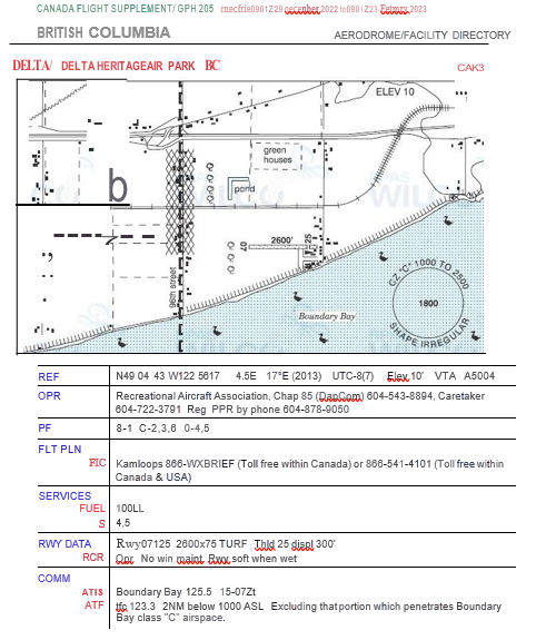

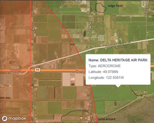

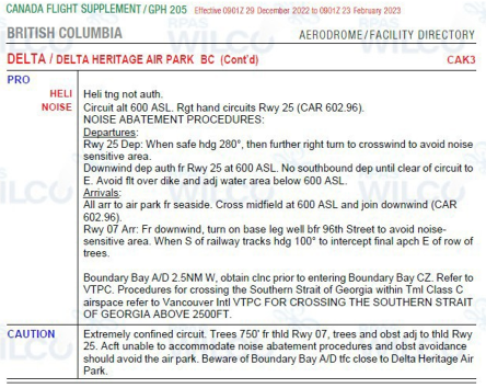

Ridge Flyers RC Flying Club operates within 3nm of an aerodrome as listed in the Canada Flight Supplement and is required to provide all members with the following information:

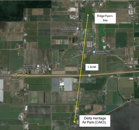

- The aerodrome name is Delta Heritage Air Park (CAK3) and it is located 1.8 nautical miles south of our modelling site.
- The aerodrome has one grass runway and is home to general aviation aircraft only with approximately 10 Cessna 172 high wing type aircraft.

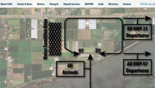

- Our modeling site is well clear of the airport traffic pattern however from time-to-time aircraft may transit to Delta Heritage Air Park (CAK3).
- In the event of a “fly-away” towards CAK3, you may call the aerodrome operator at 604-543-8899 and advise them of the issue. Our site is in uncontrolled airspace so there is no need to notify ATC.
The club executive has contacted the operator (OPR) of CAK3, and they have expressed no issues with our RPAS site.

Figure 3. Delta Heritage Air Park Traffic Pattern
Figure 4. Ridge Flyers Site in proximity to Delta Heritage Air Park (CAK3).
